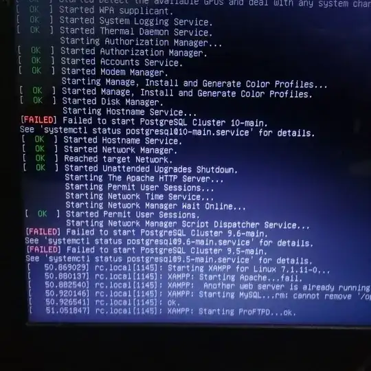

I have did what WinEunuuchs2Unix had suggest, which Turn off Plymouth to see kernel boot messages, and that's really helpful. The process got stuck in XAMPP services like image below. Its already one hour and it still in that process.
How to resolved this ?
When your computer boots up normally there is a purple screen with cycling dots. Kernel messages are hidden from you. If you computer stops to "think" for an hour we need to know what step is causing the delay. To see the steps do the following:
sudo -H gedit /etc/default/grub
This opens up gedit text editor find the line that starts with:
GRUB_CMDLINE_LINUX_DEFAULT="quiet splash ..."
Change the line to read:
GRUB_CMDLINE_LINUX_DEFAULT="noplymouth ..."
Save the file and exit `gedit. Now run:
sudo update-grub
From now on when you boot up you won't see a fancy splash screen but rather scrolling kernel messages. The message(s) it pauses a long time at you can write down or take a picture of with your smartphone. Then post these messages into your question.
Reverse the above steps to get your plymouth splash screen back, ie use "quiet splash..." in place of "noplymouth...". Note the ... represents other instructions you may or may not have. DO NOT enter ... into the command.

The long boot time does not have anything to do with the windows OS. If linux starts, it doesn't know anything about concurrently installed OS. Grub just calls the initramfs image(the basic linux boot image) and the system is on its own.
Since your error messages are quite verbose about postgres check out this post https://serverfault.com/questions/323356/postgres-connection-establishment-slow to speed up your boot time. Ensure that the service is running:
 systemctl status postgresql
