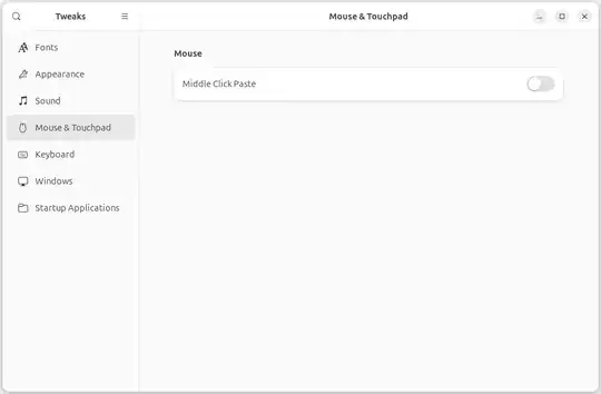

I use gnome-tweaks for disabling middle mouse button paste.
  1. Install it
    sudo apt install gnome-tweaks
  2. Run it by searching "tweaks" in the Dash or just type gnome-tweaks in the terminal.
  3. Go to Mouse & Touchpad -> Middle Click Paste
  4. Turn off.
That's it.

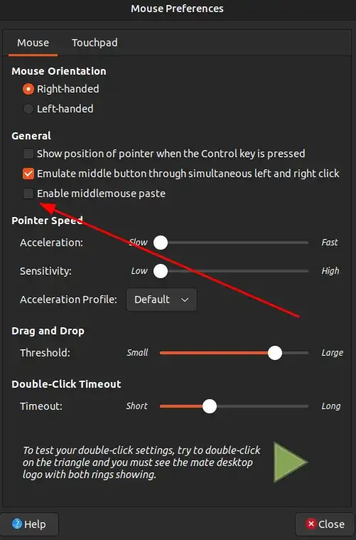

To solve this issue, I went to the Mouse option by searching it in the menu bar, then I saw Enable middlemouse pate and I disabled it.
[NOTE]:
I'm using Ubuntu Mate 22.04
[UPDATE]:
