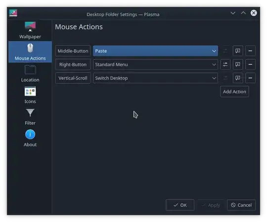

Right-click somewhere on the desktop and choose Configure Desktop and Wallpaper... from the context menu. This will open the Desktop Folder Settings window. There you can configure the mouse actions:
