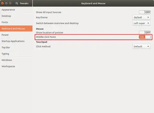

Do the following steps.
  1. Install GNOME Tweak Tool (aka GNOME Tweaks) by running
    sudo apt-get install gnome-tweak-tool
  2. Launch GNOME Tweak Tool.
  3. Go to the "Keyboard and Mouse" section.
  4. Toggle OFF the "Middle-click Paste" option.
