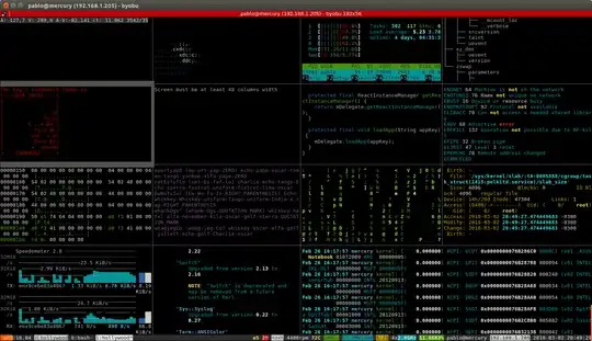

A screenshot using hollywood:
screenshot
Here is also a howtogeek article about it.
I use it with Alacritty (and more) in full-screen. Not another window: Just there at F12.
