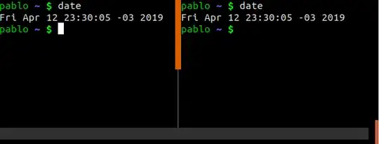

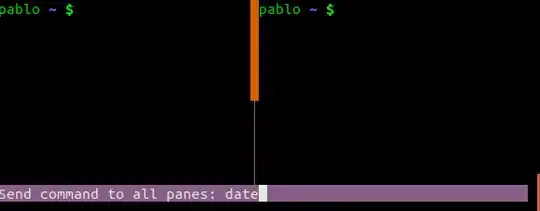

To send several commands to different terminals simultaneously one easy way could be with byobu:
Press Ctrl+F2 to vertical split, then Shift+F9:
