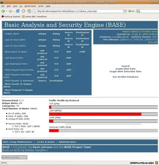

Snort https://www.snort.org/ is but one tool to monitor network traffic, may be a bit of an overkill for most users. Base is the graphical interface for snort:
See https://s3.amazonaws.com/snort-org-site/production/document_files/files/000/000/122/original/Snort_2.9.9.x_on_Ubuntu_14-16.pdf
https://ubuntuforums.org/showthread.php?t=1477696
BASE

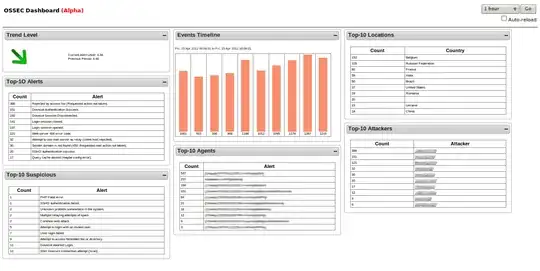

OSSEC
