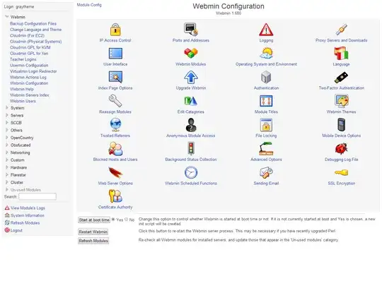

  1. Webmin http://www.webmin.com/
Webmin picture

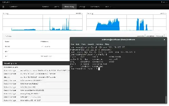

  1. Cockpit http://cockpit-project.org/

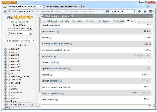

  1. phpmyadmin - manages databases https://www.phpmyadmin.net/
phpmyadmin

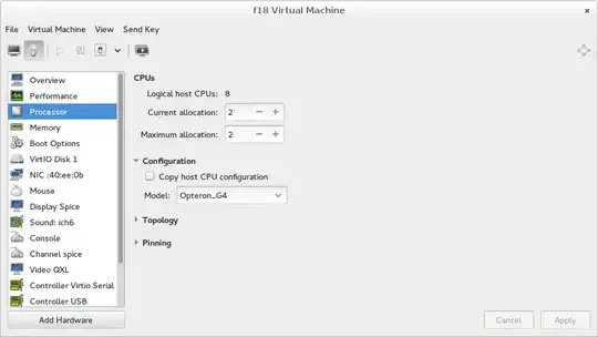

  1. Vitrualization also has several options.
Virt manager

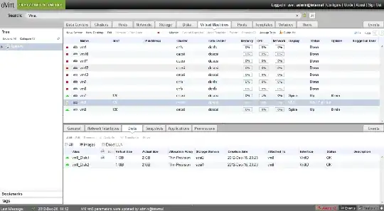

oVirt
