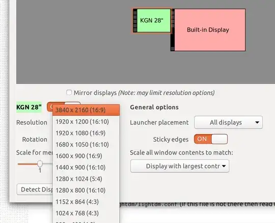

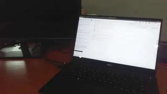

However when I try to select 3840x2160, my laptop screen becomes very stretched, and both the external & laptop screen start turning on/off repeatedly.
setting 3850x2160 resolution
Stretched laptop screen

The issue seems to be with the laptop's HDMI port, which does not support 4K@60Hz.
However, you can get 4K@60Hz over the USB Type-C port if you use an adapter, such as the official Dell one.
I'm not too sure if these work with Linux, however.
