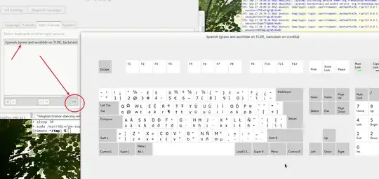

In "Internaltional Alt-Gr dead key" to have a "è" you have to press AltGr` and then e.
I don't know if the direct AltGre is defined to be anything --- I do not have the layout handy now.
You should be able to see the current layout in settings / region and language / Input Sources --- select the keyboard and press the small keyboard icon.
keyboard layout
On each key, the AltGr variants are the one on the right side. The keyboard shown is a personalized one, so it's different from the standard ones available.
You can find more info on my (mostly silent) blog here and here, and if you still have problem, check Alt-Gr key is not working in Ubuntu 13.10 and he post linked from there.
