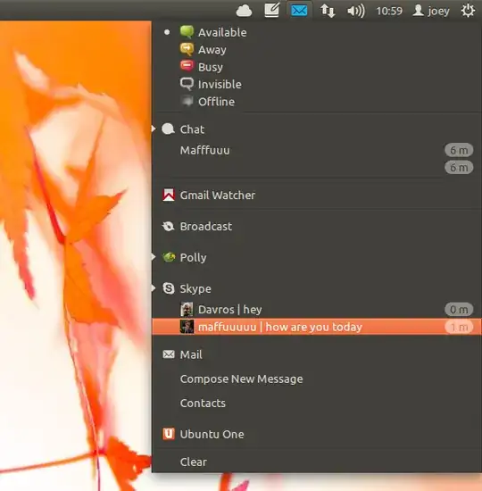

If you like how empathy and messaging tray work you can install a third party skype-wrapper package from ppa which enables Skype to indicator-message
You can install it with
sudo add-apt-repository ppa:skype-wrapper/ppa
sudo apt-get update && sudo apt-get install skype-wrapper

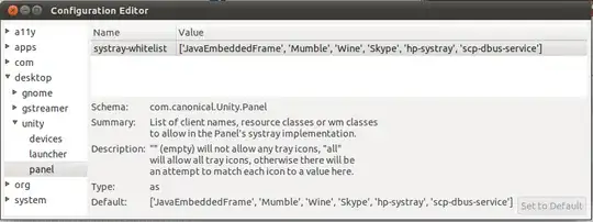

Install dconf-tools Install dconf-tools / sudo apt-get install dconf-tools.
Then run the conf editor by typing:
dconf-editor
at the command line.
There under Desktop > Unity > Panel
change the line that says:
['JavaEmbeddedFrame', 'Mumble', 'Wine', 'hp-systray', 'scp-dbus-service']`
into this here:
['JavaEmbeddedFrame', 'Mumble', 'Wine', 'hp-systray', 'scp-dbus-service', 'Skype']
You can change it to ['all'] which allows all tray applications to show there icons in the indicator bar (Ah-Duh!). As usual changes will take effect only after reboot or restarting unity by Alt+F2ing
unity --replace &
