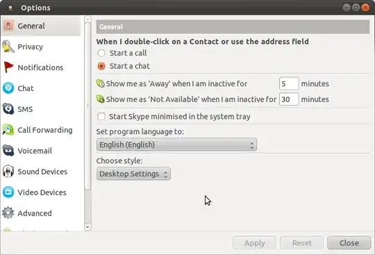

Some settings that might affect this in Skype are:
  • Start Skype minimised in the system tray
  • Choose Style
