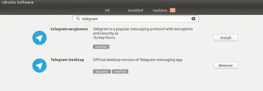

Telegram Software Center
If you are using Ubuntu 16.04 and up, you can go to Software Center and search for telegram. You should find the following:
Now click on the telegram-desktop package to install it.

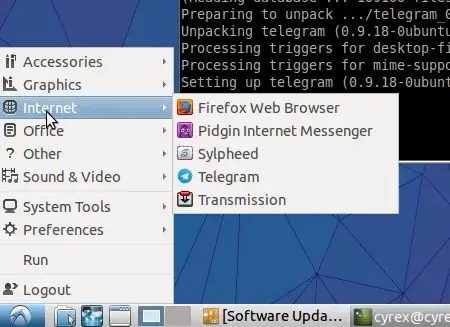

Which you can do it 2 ways, either using the PPA way, which you would simply run the following lines:
sudo add-apt-repository ppa:atareao/telegram
sudo apt-get update
sudo apt-get install telegram
or you would go to the official site and download the tar package from there and untar/uncompress the file either on your HOME folder or in the /opt folder (Whichever you want). Doing it this way you would then need to execute Telegram at least once from within the uncompressed folder.

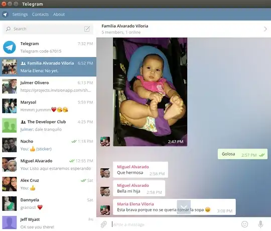

Telegram Desktop 0.9.18 on Ubuntu 15.10
It works perfectly and integrates well with Ubuntu (Including Unity Launcher and Panel). You can Drag/Drop images, files, videos and more. You can copy/paste text and do everything easily. This PPA is based on the Official Telegram Desktop in https://desktop.telegram.org/

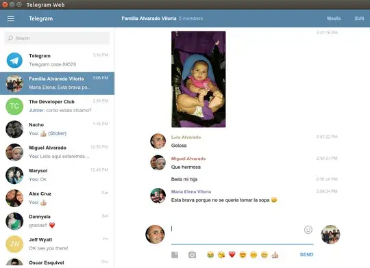

Telegram WebApps (Via PPA)
There is a PPA that can be used to work on Telegram and is based on the Webogram:
sudo add-apt-repository ppa:costales/unity-webapps-telegram
sudo apt-get update
sudo apt-get install unity-webapps-telegram

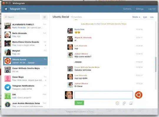

Here it what it looks running on 15.10:

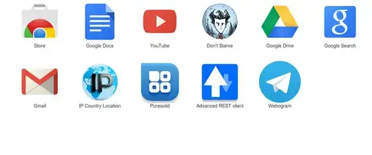

Telegram (Chrome Store)
Another way of using Telegram on your Ubuntu PC is through the Chrome Store and search for Telegram, or click on the Google Store Telegram Link. the app should appear on the App list in the Google chrome as Webogram like such:
In both cases you will only get asked once for your telephone number and a message carrying a 5 digit code will arrive on your phone. You type this code to the Ubuntu app or Chrome app and you are done.

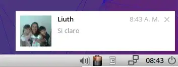

Uses Notification System              Yes         Yes          Yes        Yes
Notifies user in Tray Icon            No          Yes          No         Yes
