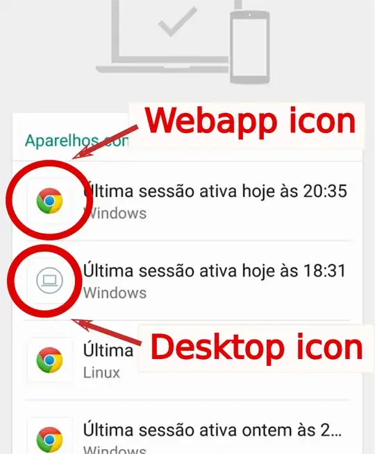

One can now install the Whatsapp Windows desktop app (not just a Webapp) on Linux using Wine. But there is a little trick. The oficial installer won't work. Is is classified as "Garbage" in WineHq:
https://appdb.winehq.org/objectManager.php?sClass=application&iId=17534
The problem is not the app it self, it's just it installer. I managed to install the Windows desktop app on Linux Mint 19 using Wine. The trick was to use his Portable apps version:
https://portapps.io/app/whatsapp-portable/
Just it.
In Whatsapp on the phone is shown with a Windows session icon. As can be seen in the figure below:
Whatsapp show as a Windows session
P.S.: Sorry for the portuguese in the print :)
