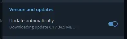

Telegram has self-updater, even if you use portable
telegram update
