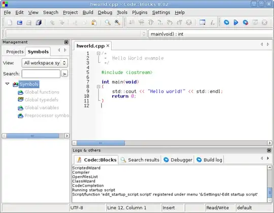

Another way I recommend is using Code::Blocks which has been known to work since I have tested it (Ubuntu 8.04, 8.10, 9.04, 9.10, 10.04 and 10.10). Works right out the box, no errors, no nothing. The one I have used so far was Code::Blocks 8.02 but 10.05 came out a couple of months ago and it looks good.
You can install it by running sudo apt-get install codeblocks.

Then you would switch to an IDE, because now you would know what to configure to what values. It's harder if you don't know what, and don't know where. I don't use C++ anymore, so I only may say that from hearsay, Code::Blocks has some good reputation.

The two most popular IDEs (If you go by reviews on the software centre) are Code::Blocks and Geany. They aren't as feature packed as Visual Studio though.
To install them you can either search on the software centre for them or stick
sudo apt-get install geany
in the terminal.

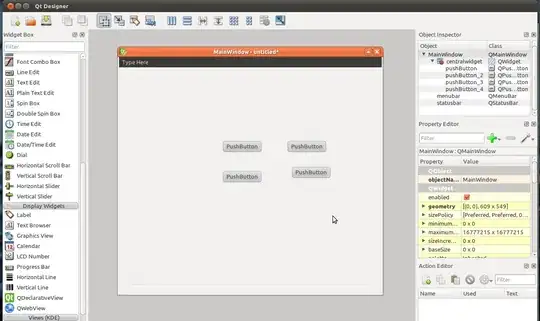

  • For general-purpose, non-GUI-related C++ development, you can use Eclipse and the CDT plugin
  • If you want to write a C++ application with a GUI, you can use Qt Creator

I recommend you to use QtCreator or NetBeans - you should try them and you will see that these 2 IDE's are the best for C++ development.
Geany, Aptana(which is actually intended for Web Development) and Codeblocks are not good when you try them all, I assure you.
P.S: Don't listen to guys that tell you that you are not a good programmer if you write programms in IDE's, that's just plain stupid and childish(when they grow up they won't think like this any more). The IDE's don't write the code for you...
To add, even some Linux Kernel developers switched to Qt Creator. Valve and a lot of other big names in the industry use Qt Creator for C and/or C++ development on Linux.
