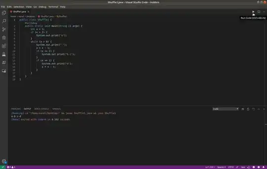

To run a code block with Code Runner, save the source code file by selecting File -> Save, and click the ▶ icon in the upper right corner of the code pane. When you hover the mouse over the ▶ icon a tooltip pops up which says Run Code (Ctrl+Alt+N). The output will be shown in the console pane which is located immediately below the code pane. The terminal command in the first line of the console pane is generated automatically when you click the ▶ icon.
code pane in Visual Studio Code
code pane and console in Visual Studio Code
