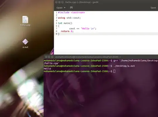

  1. Install g++ sudo apt-get install g++.
  2. Open terminal and go to file directory.
  3. Fast compiling g++ filename.cpp and run ./a.out.enter image description here
  4. Specify output name g++ filename.cpp -o filename.out.
  5. If you want to know more about g++ open terminal and write man g++.
