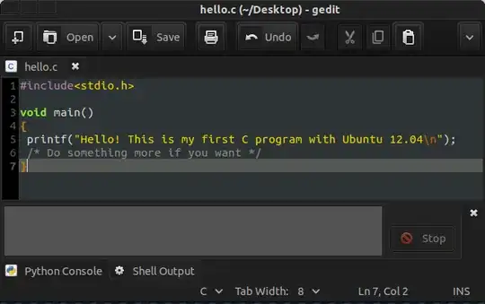

To begin with : What you will basically need is an Editor from above , ( try Gedit as beginner, there are many to choose from) for compiling through Command Line
Or
Directly use IDE ( Integrated Development Environment) such as Geany ,Anjuta or Code::Blocks IDE.
Example Using text editor
Then in terminal
gcc hello.c -o hello1
./hello1
which will give O/P like
user@host:~/Desktop$ ./hello1
Hello! This is my first C program with Ubuntu 12.04
