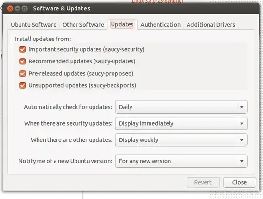

You need to first enable the proposed repositories
Then enable all 4 update sources and on the Ubuntu Software tab enable all 4 options also. Then update and you should see the 3.11.X
Do not update to the 3.12.X or the 3.13.X without knowing that you will find weird behaviors related to drivers, boot time and graphical issues. Always use the one in the updates by Ubuntu.
