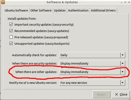

My question is very similar to Ubuntu 13.10, kernel still 3.8.0-31-generic.
Recently was updating to Saucy and the ethernet cable got unplugged. So I decided to run Software Update again, to reinstall files. It returned that "everything is up to date". But according to these command-line searches, that is incorrect. How can I install Saucy now safely?
