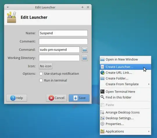

Here are a workaround for the problem:
Create a laucher on the desktop with sudo pm-suspend as command:
If you want to run this with password, tick "Run in terminal", else to get it run without entering a password follow this:

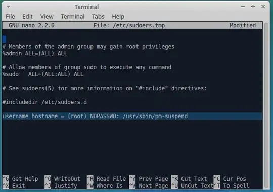

Open a terminal and run sudo visudo then go to the end of the file and append this:
username hostname = (root) NOPASSWD: /usr/sbin/pm-suspend
( More info How do I run specific sudo commands without a password? )
Replace username with your username and hostname with your host (run hostname in a terminal to get it)
Press CTRL+X to exit and save the file. Then the desktop laucher for suspend should be run without need for a password.
