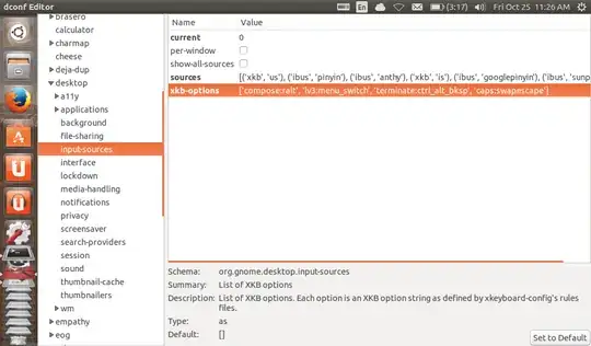

Another way to do this is through the dconf-editor. This method has a few extra steps from gnome-tweak-tool, but is useful if you don't want to pull in the dependencies from the tweak tool.
This will allow you to use the caps:swapescape syntax and automatically make the change permanent.
sudo apt-get install dconf-tools
On Ubuntu >20.04, you'll need to run the following - see this post:
sudo apt install dconf-cli dconf-editor
After starting the dconf-editor, navigate to org >> gnome >> desktop >> input-sources
Add the options that you need in xkb-options. The option strings are surrounded by single quotes and separated by commas. Be careful not to delete the brackets on the ends.
xkb-options in dconf-editor
You can use this method to enter most of the traditional xkb options that are no longer available in System Settings >> Text Entry. The exception are the settings for switching the keyboard layouts, which currently do not work because of a bug.
For a list of the options and the syntax, use man 7 xkeyboard-config in a terminal.
Another common option that could be used is terminate:ctrl_alt_bksp to allow ctrl+alt+backspace to end the X-session.

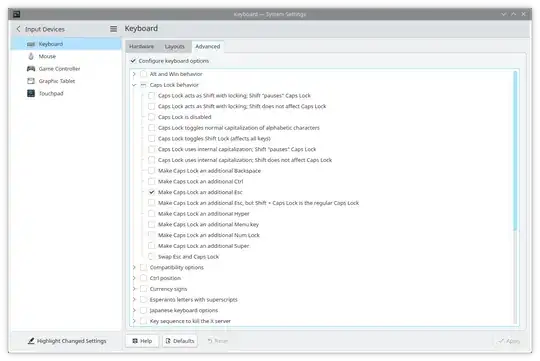

I anyone is looking for the KUbuntu equivalent it's under:
System Setting -> Input Devices -> Keyboard -> Advanced Tab -> Caps Lock behavior -> Make Caps Lock an additional Esc

On KDE GUI (graphical user interface), This can be done from Keyboard Layout on System Setting. Click on "Input Devices". On the top left corner, click Keyboard. Then click "Advanced" tab.and under "Caps Lock key behavior" choose "switch Escape and Capslock".
