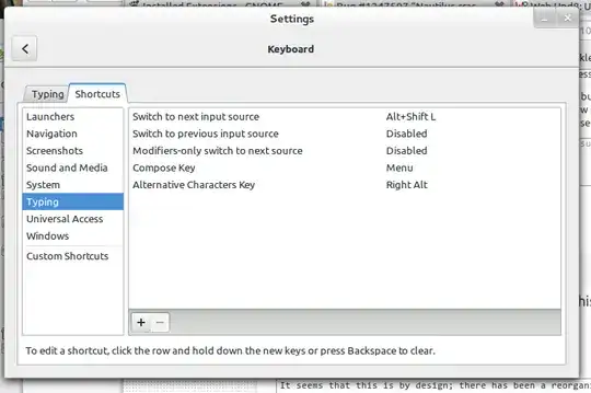

It seems that this is by design; there has been a reorganization of the keyboard/input methods. Now the keyboard configuration is accessed by system settings -> keyboard, tab shortcut, Typing entries:
keyboard typing shortcuts
But quite a lot of options is just not here anymore, like the settings for ctrl-alt-backspace.

Use the shortcut key to switch back to the US keyboard source. In System Settings > Keyboard, select the Shortcuts tab, then select Typing. Try pressing the key combination shown as Switch to previous source or Switch to next source.
