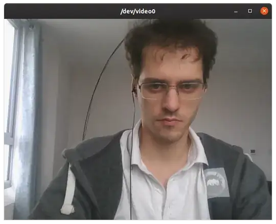

sudo apt install ffmpeg
ffplay /dev/video0

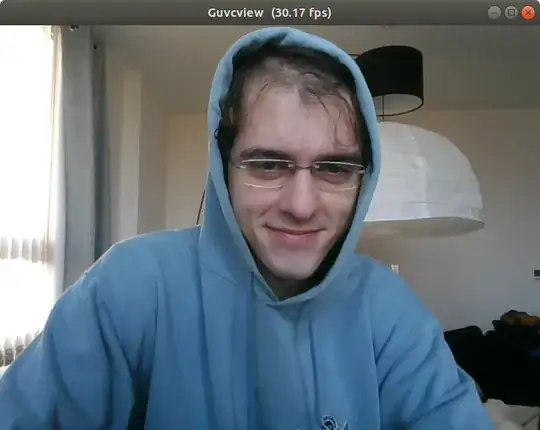

Another good one that shows only camera and nothing else:
sudo apt-get install guvcview
guvcview

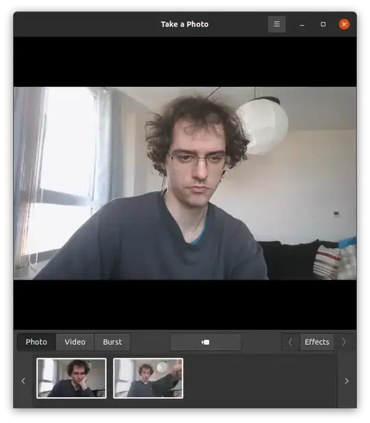

For non-minimalists, Cheese is a simple and good GUI program:
sudo apt install cheese
TODO as of Ubuntu 23.10, the audio and video were about 0.5s out of sync which was noticeably annoying. Another program that overcame the offset was the weirdly named guvcview:
guvcview
This one seems to also have more configuration options, but was still quite simple to use.

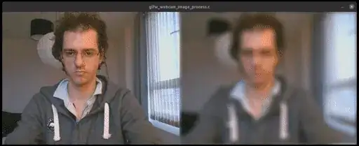

Read camera data from C/C++
https://stackoverflow.com/questions/4290834/how-to-get-a-list-of-video-capture-devices-web-cameras-on-linux-ubuntu-c
A concrete C++ example that processes images from the camera on the GPU with OpenGL and shows it live: https://stackoverflow.com/questions/13693946/image-processing-with-glsl-shaders/40641014#40641014

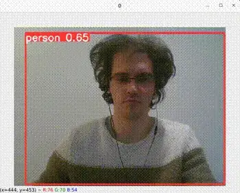

Just having some fun at this point
python -m pip install -U yolov5==7.0.9
yolov5 detect --source 0
Tested on Ubuntu 22.10, Lenovo ThinkPad P51. Ludicrously low GIF resolution uploaded here to fit the 2 MB max Stack Exchange image size, raw at: https://www.youtube.com/watch?v=1MD3Wn7e6OE showing that it handles my actual camera resolution.

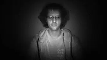

video2 infrared device
I was re-running parts of this answer on my newer Lenovo ThinkPad P14s with Ubuntu 23.10 when I noticed that now I had a video2 and video3 which peaked my interest. video3 was the metadata for video2 like video1 is the metadata for video0. But what was this mysterious video2? Comparing to my main camera:
diff -u <( sudo v4l2-ctl --device=/dev/video0 --all ) \
        <( sudo v4l2-ctl --device=/dev/video2 --all )
I saw that it was some kind of low resolution greyscale camera:
-       Width/Height      : 1280/720
-       Pixel Format      : 'MJPG' (Motion-JPEG)
+       Width/Height      : 640/360
+       Pixel Format      : 'GREY' (8-bit Greyscale)
and Googling suggested that it was infrared, which I had no idea I had! Apparently the use case is facial recognition to unlock devices so as to make it harder for someone to unlock the device with just a video of your face, and is used in particular by "Windows Hello".
ffmpeg -f v4l2 -list_formats all -i /dev/video2
gave:
[video4linux2,v4l2 @ 0x5e00d8e51ac0] Raw  : gray :  8-bit Greyscale : 640x360
and so I managed to record a video with:
ffmpeg -y -f v4l2 -framerate 30 -video_size 640x360 -input_format gray \
  -i /dev/video2 -c copy out.mkv
TODO is the framerate actually 30?
A red LED lights up while that camera is being used on this device, rather than a white LED which shows up when the regular camera is in use.
