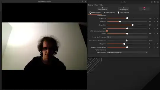

Guvcview
This is another good one:
sudo apt-get install guvcview
guvcview
It has more options than Cheese, but it is still easy to use. Also on Ubuntu 23.10, Cheese had a small issue that the audio was offset by about 0.5 from video, and that wasn't happening on guvcview.
