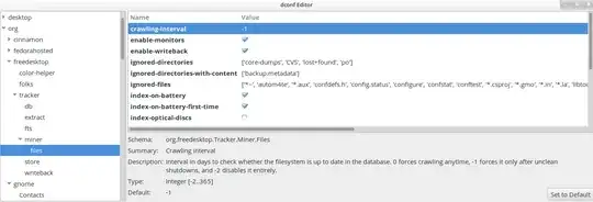

Simply change this values using the gsettings witch will disable the constant indexing of Tracker:
gsettings set org.freedesktop.Tracker.Miner.Files crawling-interval -2
gsettings set org.freedesktop.Tracker.Miner.Files enable-monitors false
The values could be changed using dconf-editor by navigating through org > freedesktop > Tracker > Miner > Files:
After this changes, it is highly recommended to cleanup the database to reclaim some lost space on the disk:
echo y | LANG=en tracker reset --hard

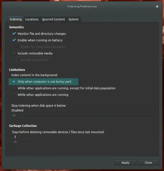

OR maybe the most appropriate way for systems with running tracker-store:
Applications > System Tools > Search & Indexing
List item
