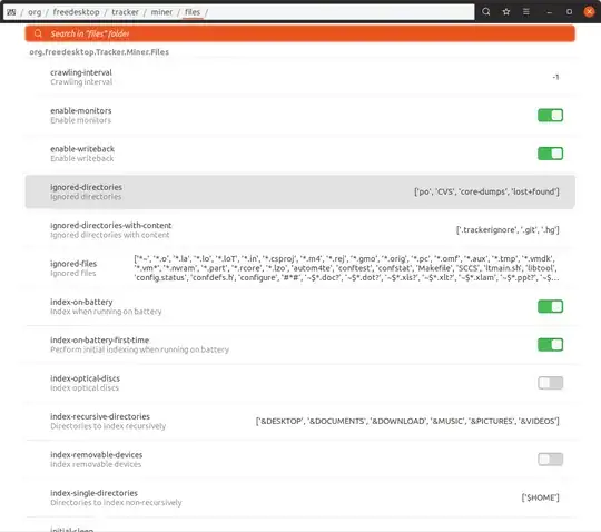

I see its enabled using dconf-editor ->org->freedesktop->tracker->miner->files
What remains unanswered is who benefits from this running ? Can I also subscribe to the feed sent to the mothership to allow me to see who is using my packages/applications if that is what this tool is doing ? What is the big picture here ?
