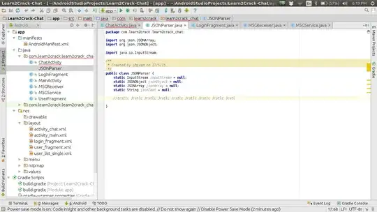

Whenever I tried to write something in the editor window, the random text "Jrstlc" started appearing. Whenever I hit a button on my keyboard only this text was being repeatedly written in the editor.
This screenshot shows the "Jrstlc" being repeatedly written:

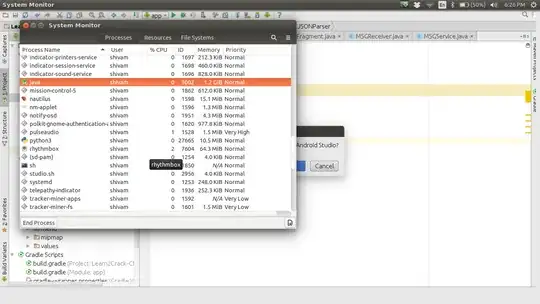

I opened up the System Monitor and it showed Android Studio using '1.2gb' memory.
This screenshot shows the high memory usage by android-studio:

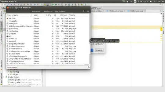

And then down the list I saw some services starting with the name 'tracker'.
This screenshot shows the 'tracker' services:

  1. Tracker is a search engine, search tool and metadata storage system.
    It allows you to find the proverbial needle in your computer's haystack as well as providing a one stop solution to the organisation, storage and categorisation of your data.
    Source and more Infos, thx @solsTiCe for the hint
  2. tracker can consume a lot of resources
    Install iotop, a simple top-like I/O monitor
    sudo apt-get install iotop
    Start iotop in a terminal and monitor the output of tracker processes
  3. The memory usage of development environments of this type is normal.
    Install htop, a interactive process viewer
    sudo apt-get install htop
    and start with htop in a terminal. Press F5 for the tree view and search for java. Look at the information on the sub-processes. There you'll see more detail, who needs as much RAM.

The tracker app sounds like a good idea, but it's not ready for prime time. I also use Android Studio and notice laggy performance. the "top" command shows the various tracker processes running at the top of the list. I see my load average reaching 6 or 7 and my memory use nearing 100%. This is with the default settings for tracker after exiting Android Studio. It is supposed to do its work without interfering with normal use, but that is not the case. I see other software failing (i.e., network apps timing out) due to the excessive load. You can adjust tracker settings (in 15.04) by running "tracker-preferences". I have removed everything from the "locations" list, now my system is usable again.
