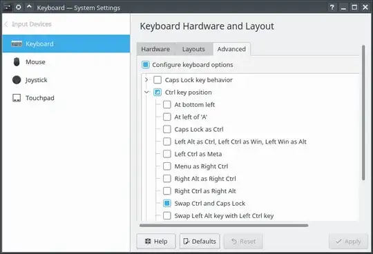

On KDE-based distributions (like KDE Neon or Kubuntu) this behavior can be configured in the regular system settings. Open the system settings, select "Input Devices" => "Keyboard" => "Advanced". In the category "Ctrl key position" select "Swap Ctrl and Caps Lock".
Screenshot of KDE's System Setting's Keyboard module

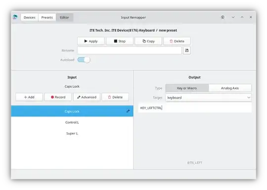

The input remapper ubuntu package can easily remap keys and has a GUI example of swapping in the gui
KhalfaniW
  • 121
