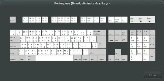

Yes, it does. You only have to check the Layout list and look for Brazillian. Go to System Settings, then Region and Language, Layouts. Hit the + symbol:
In the search box type Brazil
Select Portuguese (Brazil, eliminate dead keys), then click Add. Done.
This is how the Layout looks like.
