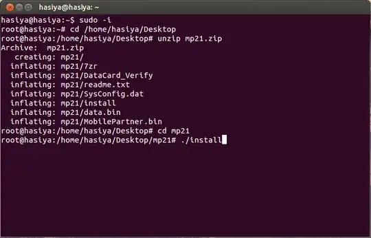

How to Install
  • You need login as root:
    sudo -i
  • Go to the directory you downloaded the file to using cd, for example
    cd /home/hasiya/Desktop
  • Unzip
    unzip mp21.zip
  • Go into mp21 folder
    cd mp21
  • Install MobilePartner by using the install script
    ./install
  1. If you had installed this software in your system before, you will get a prompt: "The software is exist, do you want overwrites? ([Y]/[N])", enter "y" to overwrites or "n" to exit.
  2. If you do not had installed this software in your system before, you will get a prompt: "Please input the install path[/usr/local/Mobile_Partner]:". Then you can input install path(fullpath), or you may using the default path(/usr/local/Mobile_Partner) by press ENTER direct
  3. Finish installing

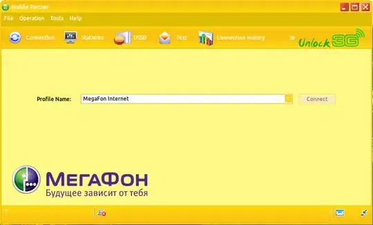

How to run
  • Run MobilePartner in your install path eg: # //MobilePartner
  • Plug in your device, it will run automatically (Not supported in Xandros)
You have installed Mobile Partner to your Ubuntu machine, final result :
