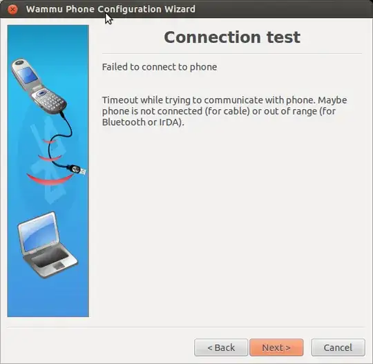

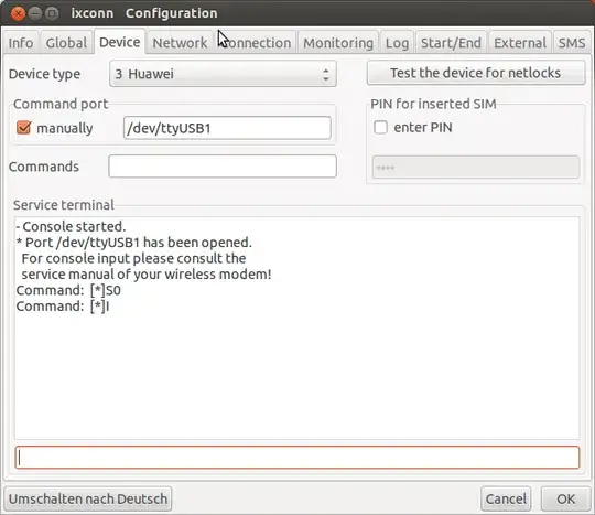

I have Huawei USB modem E353. But it is just working with Ubuntu 12.04. I am able to connect to internet.
But I am not able to use ixconn and Gammu for retrieving messages. I need USSD Functionality. Please advice me on how can i acheive this.
Modem is detected as Bus 002 Device 005: ID 12d1:1506 Huawei Technologies Co., Ltd. E398 LTE/UMTS/GSM which is not my modem.
