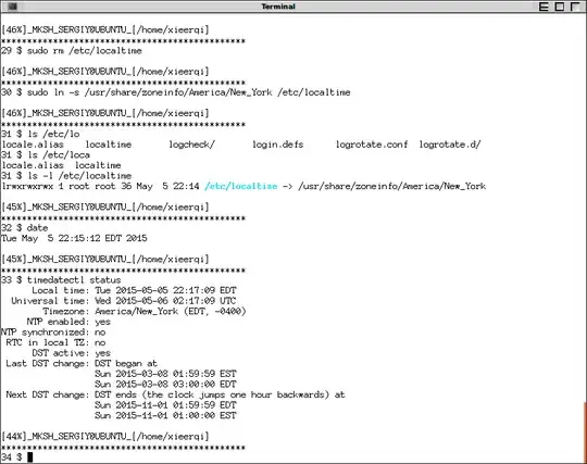

18
TL;DR /etc/localtime is a symbolic link that points to a file in /usr/share/zoneinfo/Continent/City. By altering where it points you can alter your timezone.
In order to change timezone, remove the /etc/localtime and assign symbolic link to your desired city. For instance, ls -l /etc/localtime reports that this file points to /usr/share/zoneinfo/America/Denver. To change it to New York, I do
  1. sudo rm /etc/localtime
  2. sudo ln -s /usr/share/zoneinfo/America/New_York /etc/localtime
  3. Wait a minute for my clock to get updated
The screenshot bellow shows the steps and confirmation from timedatectl
