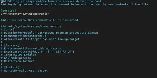

This is an updated answer for Ubuntu 22.04.
The answer is about setting the timezone for how jobs are scheduled. Also the answer assumes that you do not want to change system-wide default timezone. You only want to change the cron daemon's timezone. In the example below we want cron to interpret sheduling instructions in the crontab file according to timezone Europe/Paris (replace with your own example).
Unlike some other Linux distros, Ubuntu does not support any CRON_TZ variable to be put in the crontab file. You can only set timezone for the cron daemon as a whole.
Here is how:
  1. Add an override to cron's systemd service definition. This is done with the systemctl edit cron.service command. Add text like this:
[Service]
Environment="TZ=Europe/Paris"
...but in the right location as shown here:
enter image description here The cron deamon will now run with TZ=Europe/Paris
  1. Restart the cron daemon : systemctl restart cron
How to check it is working
  • You can check the merged config for the cron service with this command: systemctl show cron.service. You should be able to see a line such as Environment="TZ=Europe/Paris" in the output.
  • Find the PID of the cron process. Something like ps -efd | grep "usr/sbin/cron" will tell you the PID. Now you can do cat /proc/$PID_OF_CRON/environ --show-nonprinting which will tell you which environment variables the process is executing with. You should be able to see the TZ variable in the output.
