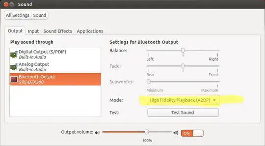

I have to set the preferred bandwidth mode to "High fidelity playback" (A2DP) each time after switching on the computer and reconnecting the speaker.

After setting up this...
A2DP

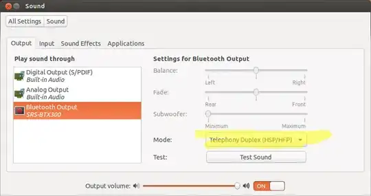

... the preferred mode will be reset to this after restarting/suspending the computer
Telephony Duplex
