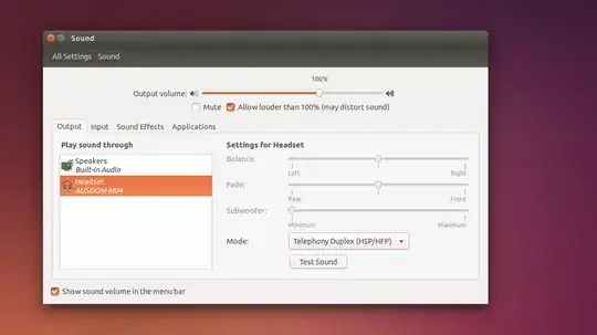

I have a bluetooth headset (Ausdom m04). At first, I couldn't set up the device as the laptop couldn't find the device. Then, after a couple of hours, I managed to connect it but there was no sound. These two threads helped a lot by the way:
  1. My ASUS pc seems to lose its bluetooth firmware when I dual boot? I have reset it numerous times.... frustrating
  2. Bluetooth device paired and connected (no sound)
Now, I have a problem which is about the quality of the sound. When playing sound through the headset, sound mode is Telephone Duplex. Even if I change it to High Fidelity Playback (A2DP), it still goes back to Telephone Duplex mode automatically. Notes: - Ubuntu 14.04 - Bluetooth headset supports A2DP. - Tested it on Win 7,8,8.1,10 and works like a charm.
Please help.
Nikasv
  • 101
Add the following line to /etc/bluetooth/audio.conf:
[General]
Disable=Headset
then run
sudo service bluetooth restart
(taken from this thread)
