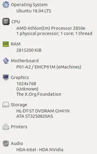

Here's all I know at this point:
image capture of specs
*-display
description: VGA compatible controller
product: C61 [GeForce 6150SE nForce 430]
vendor: NVIDIA Corporation
physical id: d
bus info: pci@0000:00:0d.0
version: a2
width: 64 bits
clock: 66MHz
capabilities: pm msi vga_controller bus_master cap_list rom
configuration: driver=nouveau latency=0
resources: irq:23 memory:fd000000-fdffffff memory:d0000000-dfffffff
memory:fc000000-fcffffff memory:c0000-dffff
