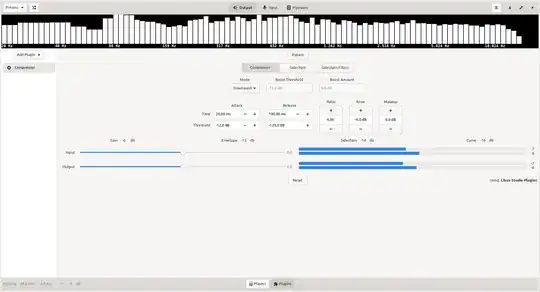

I recommend EasyEffects (formerly known as PulseEffects). It's an application, where you have lots of tools to manipulate sound system-wide (includes compressor). Pretty easy to use.
For me this setup works best in movies: enter image description here

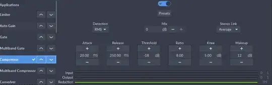

EasyEffects (which does require Pipewire however), which is a newer version of PulseEffects.
I think it's a great software product!

Here is the stereo plugin with better control settings (Much less clipping) following ændrük's answer that uses the mono plugin example.
load-module module-ladspa-sink sink_name=compressor plugin=sc4_1882 label=sc4 control=1,1.5,300,-20,3,1,10
