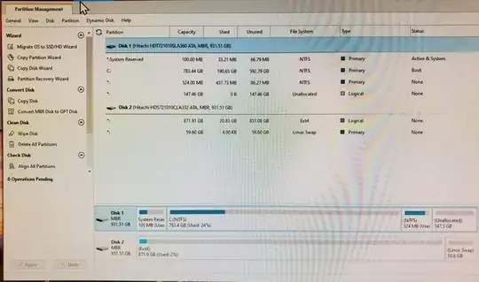

The only trick here was that I did the Live install of Ubuntu (not writing to any hdd). Then with the PC still running I plugged in the 2nd drive and installed & ran Gparted. This allowed me to delete all the old partitions on the 2nd drive and create a new ext4 Linux partition + a 60 GB Linux swap partition.
Following the setup link provided by usr535733 how-to-install-ubuntu-on-separate-hard-drive-in-a-dual-boot I was able to get it to work. Attached is the Partition table as shown by MiniTool from the Windows-10 side. The Unallocated 147.5 GB partition used to hold all my Linux OS, data, & swap.
Partition table of both drives
