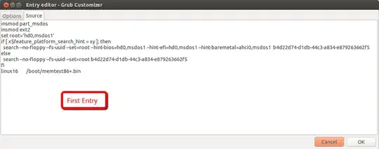

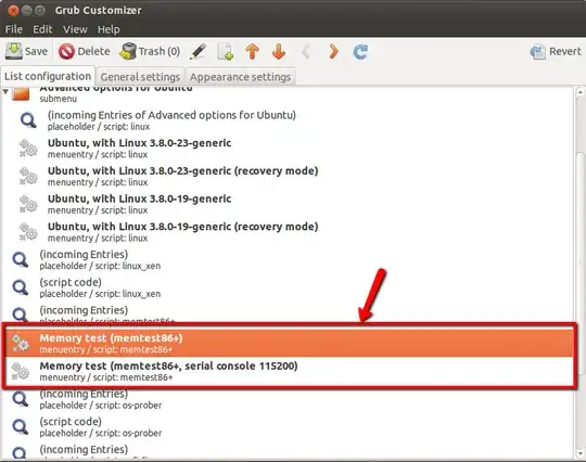

To add the memtest entries see images below, and the text.
enter image description here enter image description here enter image description here
First Entry
insmod part_msdos
insmod ext2
set root='hd0,msdos1'
if [ x$feature_platform_search_hint = xy ]; then
  search --no-floppy --fs-uuid --set=root --hint-bios=hd0,msdos1 --hint-efi=hd0,msdos1 --hint-baremetal=ahci0,msdos1  b4d22d74-d1db-44c3-a834-e879263662f5
else
  search --no-floppy --fs-uuid --set=root b4d22d74-d1db-44c3-a834-e879263662f5
fi
linux16 /boot/memtest86+.bin

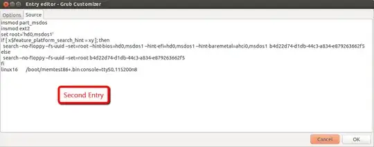

Second Entry
insmod part_msdos
insmod ext2
else
fi
linux16 /boot/memtest86+.bin console=ttyS0,115200n8
