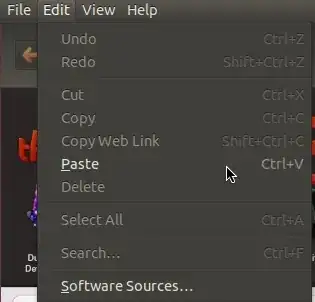

Something I always try to do whenever I am updating Ubuntu 12.04 packages is make sure I will be downloading them from the closest/best mirror/server.
  1. Begin by launching the software center.
  2. Select edit from the menu bar, then select Software Sources. ..
Software Center Edit Menu

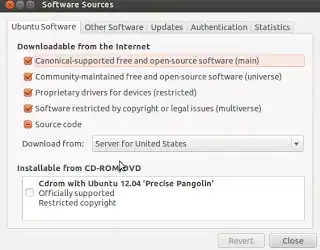

  1. Click the drop down arrow for the Download From options.
Package Sources download options
  1. Choose other.
other download server
  1. Click "Select Best Server."
Selecting Best download server ubuntu 12.04
  1. Software center will now perform a series of tests to find the best mirror for your location.
Finding Closest Server
Source: http://www.ubuntulinuxguide.com/sudo-apt-get-update-error-slow-mirror-ubuntu-12-04/
The error you have got is because the link has actually been removed. This might be temporary or the server might not be working properly or under maintenance.(in your case the package files have not been uploaded on the server)
To solve this you try changing your download source(this may or may not work depending on the server)
open software sources
click on ubuntu software tab
then in Download from choose other and then click on select best server
After that software sources will automatically be updated.
