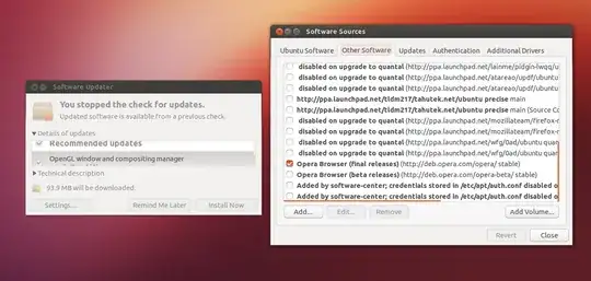

Just like a browser can show a error message a Update Manger can also do it.
You can stop update it if theres nothing you can do. by remove a software source
also chose another mirror can help you,maybe server you chosen was down.
