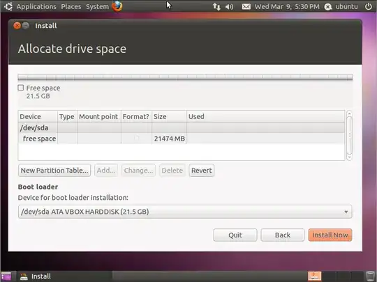

Second, select the partition you want to format/partition. (In this case I have an empty hard drive. not yet partitioned).
Second "Allocate drive space" window, with the /dev/sda drive selected

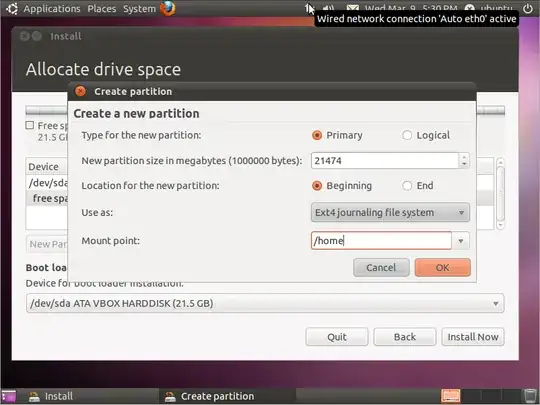

Third, select the partition size, and the most important part is to have the MOUNT POINT entry point to /home. This will make a partition for home. Also remember to add the root partition and swap partition.
"Create partition" dialog box is open, with mount point set to /home .
