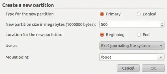

Once you see this screen you need to resize the root partition (ext4) and then use the Add button to add a new partition:
Where you see "mount point" that should say /home and the size should be an acceptably large size for your home partition.
WARNING! Having a separate partition has it's down sides, you will not be able to adjust the amount of free space between your ubuntu partition and your home directory later, it's very fixed so think carefully about how much space you really need.
