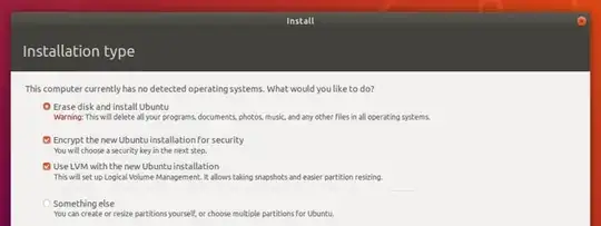

At what point during the installation of Ubuntu 18.04 do I get the option to encrypt my disk?
Somehow I missed it, so if I'll need to start over I'd like to know where to look.

Here it is, the second option:
I hope you know where to look now. :~)
