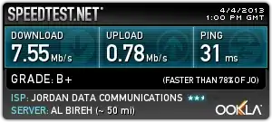

I'm not an experienced user but as you can see in the image.:
speedtest image
I've got the same connection.
That happened to me while using an old Ubuntu version, and the problem was that my computer wireless USB adapter was 802.11g. When I change it to 802.11n the problem was solved (its possible you only need to adapt the drivers).
I know that with your computer knowledge this could be a stupid answer, but consider my intereset on helping.

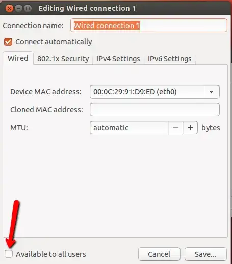

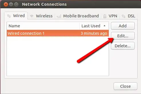

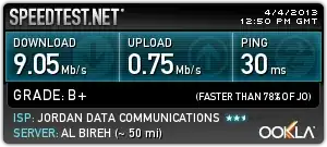

Also try turning off internet sharing by unchecking Available to all users. I just tried it, ans it made a difference. To do so see below:
enter image description here enter image description here enter image description here
With the option Unchecked
With the option Checked
