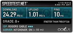

Here is what I am dealing with; In Windows my internet is as normal, nice and fast. enter image description here
However in ubuntu on my new system my internet is super slow (Here it is important to note that my other system ubuntu has the same speeds as windows on this system). I have installed all of the updates and am using the latest stable google chrome and my speedtest results are way lower. (upload times out and eventually fails, however before that happens ping is 10ms and download is <5meg). the difference is really felt when downloading anything, including updates.
