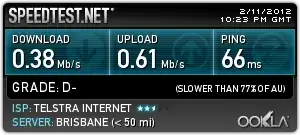

Unfortunately I am experiencing slow download speeds on Ubuntu 11.10 but not on Windows Vista. My limited knowledge with Ubuntu and my subsequent flawed research to resolve the matter suggest, it might be a problem with Ath9k.
