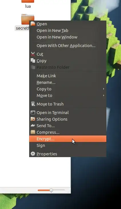

I use Seahorse for this. It's a Gnome front-end for GnuPG and integrates well with nautilus: Nautilus integration
To get nautilus integration, install the package seahorse-nautilus from the Software Center: seahorse-nautilus Install seahorse-nautilus
